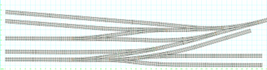

For quite some time I’ve been considering build a small steam/diesel cross-over era loco shed. At the end of last year, I decided it was about time I got started.
First stage was a design and to help with that I thought I’d better learn how to use Templot. It took a couple of days but it has been really worth the effort., thank you Martin Wynne. My thoughts were that it was an old steam shed that had been modernised by the addition of a servicing facility for the diesel locos that were appearing. After a lot of trial and error the design was finalised as per the first photo.
Locos enter the yard at the top right. The end of the two top roads on the left will the location of a two track steam shed and the two below are for the coaling tracks.
The bottom left road provides access to a two-track diesel maintenance shed which will be situated on the far right bottom two tracks. Above these is a storage road for diesel fuel tankers.
The layout is 13’ 3” long and 3’ 6” wide, this being a size that will fit into the middle of my garage. It’s comprised three boards which whilst not designed to be exhibited will allow it to be moved fairly easily.

I like your plan but is the entry track (top right) a tad short, will you get a reasonable sized loco clear of the point blades to change the points?
regards
Tim Humphreys ex Mudhen
Good spot Mike, the plan is that there will an extension on that corner leading to a fiddle yard. That board will run to the side of the oak column in the fist of the layout photos.
