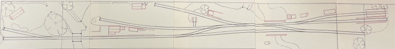

What I'm considering is adopting a modular build. Stage one will be the terminus, based on this...
I wll have to compress things to fit into a 140cm length. Depth will be 40cm. The point alongside the engine shed will be flipped to a left hand. In addition, the crossover ahead of the loading dock may done away with. However, I think doing so will compromise goods workings which I believe used the centre road only so more research is certainly needed on this before a final decision is reached.
A separate module will feature the mill siding but will be exhibitable only as a rather limited diorama or more normally as part of the main layout, something not possible in the Room of Doom due to space.
Still much thought to be given though as we are very far away from any start being made but as a layout plan, it's quietly coming together.

In addition, pretty certain that the siding to the mill should be facing in the opposite direction.
Nope that's the correct direction. I know it looks wrong but there it is. If you think the original intention of the line was to get to halesworth and as the crow flies the mill was a little closer to that end of the line than haughley so it makes sense on a completed system to have the siding orientated to be able to dispatch traffic working towards Halesworth.
Hi Rob,
I'm visiting my Mum, so to ease the boredom, I have Temploted your track plan to suit your layout size. Most of the turnouts are A5s, but one is A4.75 and is a slight Y, to maintain an almost minium 24" radius.
I have not cleaned up the timbering.

The mill should be on the same side as the allotments which in my world would be on the 'public' baseboard edge. So agreed. Not facing in the wrong direction but on the wrong side of the track.
There's definitely a little bit of artistic licence going on in John Watsons plan and probably with good reason behind it.
The other thing to note from the plan is the position of the water tower. If were being completely accurate this should be by the shed. There was a point where the locomotive took water between the station and the mill siding but this was just a pond. Might be a nice feature it include?

There were two water towers at Laxfield, George.
One was at the corner of the engine shed. Not shown on John's plan but seen here in Rod Cameron's image of John's Laxfield. Rod, amongst others, currently has 'ownership' of Laxfield and I was lucky enough to be able to have a good look over it in July last year.
Another view from Dave Dorman.
The other was at the pond and of a similar construction to that at the engine shed. This will be included on the 'Mill' board. There are pictures of 65447 ( still attached to it's coaches ) at this water tower and of 65388 at the pond included in Peter Paye's book. ( must get a second copy of this. My signed copy is getting well thumbed )
