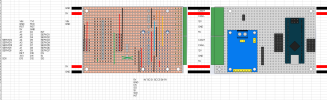

unfortunately the circuit diagrams are drawn in an Excel file and I can't upload same, but the picture will help, I hope - this is the two sides of the slave board, with an arduino and a CAN interface mounted one side, along with two 5-way sockets for the CAN bus and some 3-way connectors for the servos.
Arduino servo commands are well covered by the IDE documentation. https://docs.arduino.cc/learn/electronics/servo-motors/
The CAN interface is an MCP 2515 - £0.77 from Aliexpress.
I was going to make some custom boards that simply use the chips that the MCP2515 uses, but I have not yet got around to that. And at 77p...
Shout up if I can help with anything
With a bit of faffing I got the servo slave to operate servos, Dapol signals or colour lights. No hardware changes, just a couple of lines of code
Note that the servos do not need to be attached to the slave in any particular order, you just associate each one with a particular lever.
S
