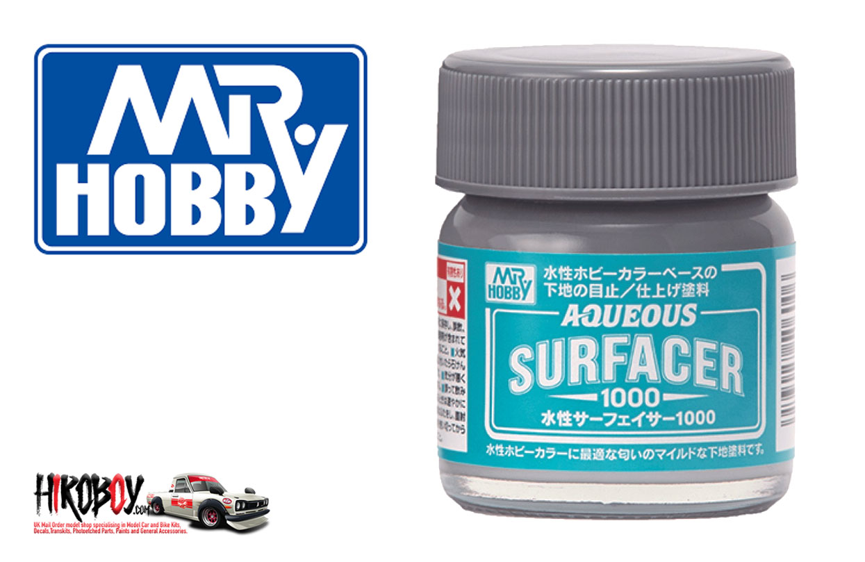

Here you go.....
No solvents!! There is lot of temptation at Hiroboy. I need to find RALs for the various GWR greens. I would like to find the Wolverhampton green for a very slow moving scratchbuild.
SimonT
Pete,
thank you. I'll give it a try with Hiroboy ready mixed celly paint. Unfortunately my 633, dressed in Wolverhamptons finest, is on loan so I cannot match the RAL to the Precision Paint from thirty years ago. I opened up my copy of Great Western Way to find all had all turned to a dark colour.

Here you go.....
These guys appear to be cheaper and have a very wide range of scenic stuff too
