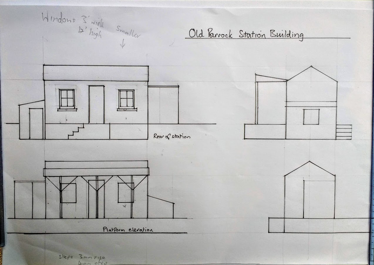

    The grace of an extra year has enabled me to change the concept of the cameo a little and I'm excited about the new idea. The layout will now be a light railway terminus (acquired by the LBSCR, run by the Southern Railway). The KESR is the inspiration. With that in mind I have re-aligned the front of the loop to give me extra space for a small platform.
    This photo shows the platform base with the extra piece at the rear for the building which I've designed by drastically reducing the vernacular KESR architecture. This is my indicative drawing:

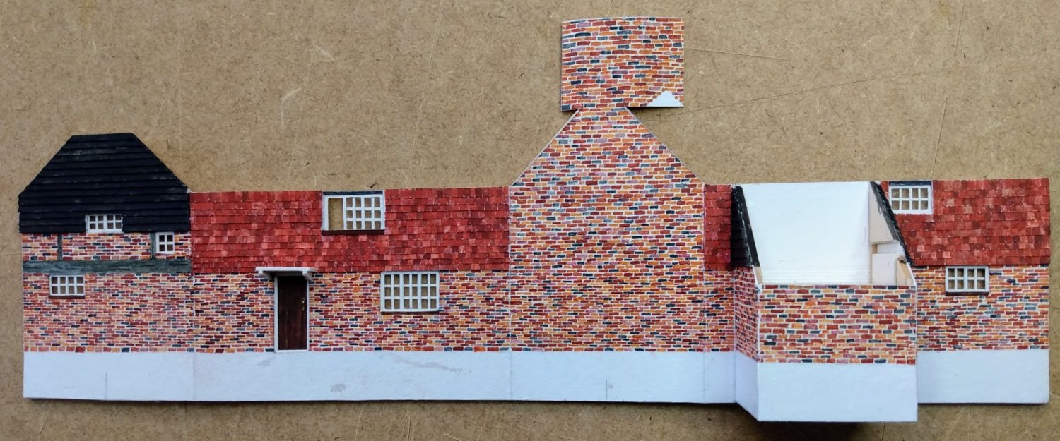

    Here's a quick update on progress with the cottage:
    The next stage is to fold it up and glue it. I'm using 1/16" basswood for the frame. There will be touching up to do once it's constructed, and the roof, doorstep, down pipes etc, all those things that bring it to life. I'm cogitating on how to tone the colours down a bit as it looks a little bit like the Technocolor of a 1950s western at the moment - more on that later.

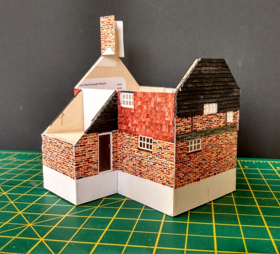

    It has now become three dimensional:
    I need to add a couple of strips around the weatherboarding, and to touch in the corners, but I'm really looking forward to cracking on with the chimney and the roof.

    Very nice Paul.
