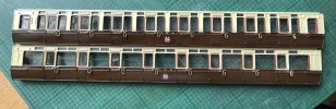

Where I am as I type. The C31 is on top, and needs the frosted glazing for the toplights. I’m not sure my sanity can deal with it today. The E85, at the bottom, is completely glazed and all the glue cleaned up. I still need to make up the corridor grab rails for both these coaches.

That top pic is interesting - Those of us who had certain past employments and are of a certain age have good reason to be thankful for the existence of Makrolon i.e., polycarbonate sheeting - though arguably slightly thicker than Heather is using for model carriage glazing. I saw the pic and had an involuntary image of a past existence appear.
