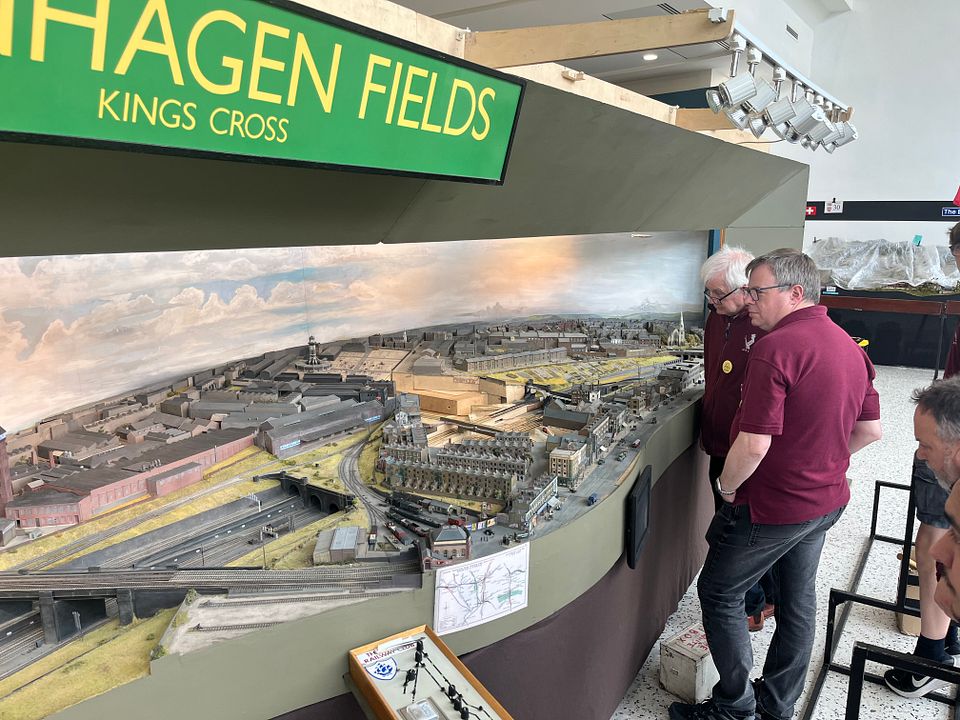

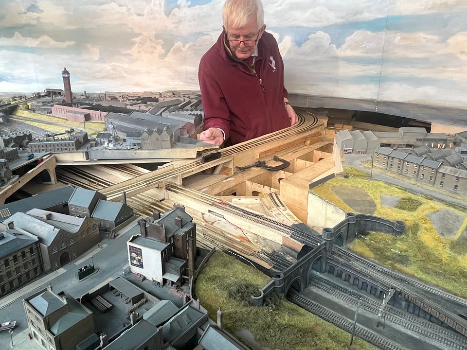

Taking CF to a show is quite a logistical challenge, but one that has become more and more streamlined over time. It is a big lump of layout.

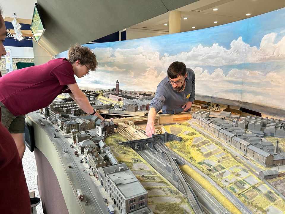

Every single baseboard joint has to be perfect(ish) and is checked as the main ring of the layout is set up and levelled. The scenic in-fill boards followed by the back scenes complete the construction phase. Joints can move at this point so they are again checked where possible. One joint was not quite right on Saturday running at York was the hidden NLR lines. It probably moved when the scenery was inserted. Of course, once the scenery is in place, access is very challenging. At the end of the day we investigated.

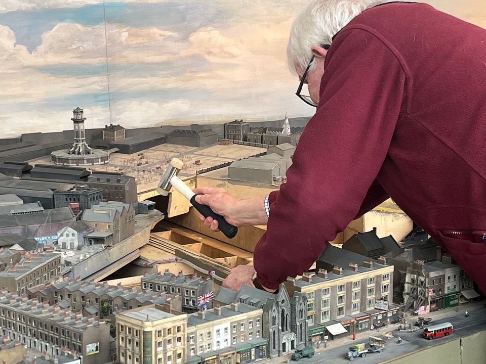

Sometimes, a sharp tap with a mallet will do the trick, but not in this case.

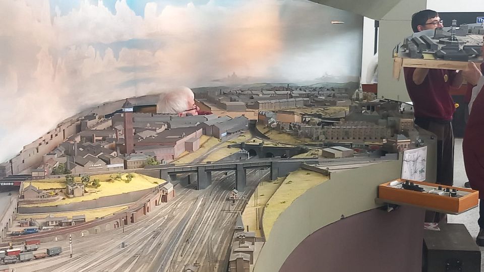

Another scenic section needed to be removed to improve access.
A biased G cramp was used to horizontally shift the errant joint and then seriously tighten up on the main bolt.
