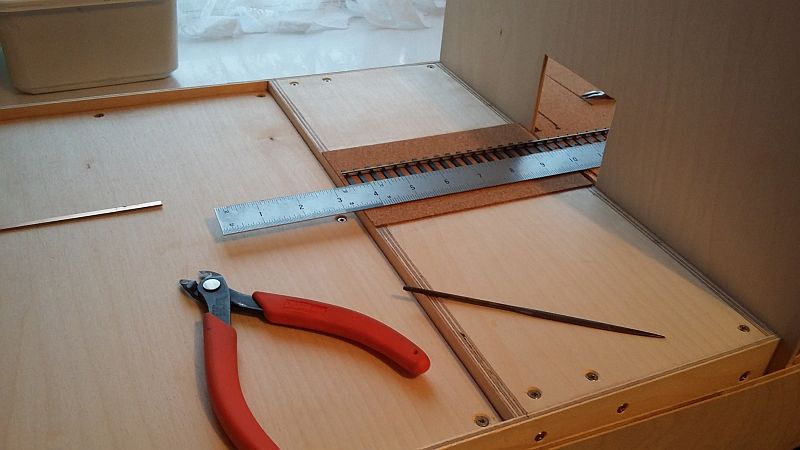

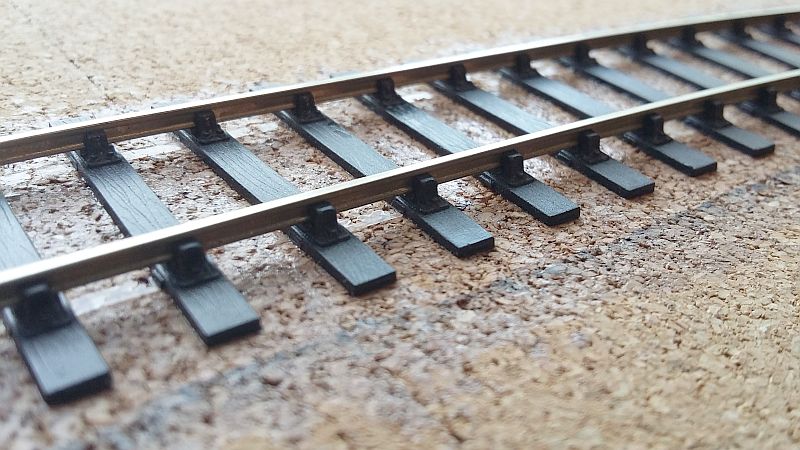

Well, I've now finished cutting all the plastic webbing from between the sleepers:
With this thin-sleepered C&L track, once the track has been painted and weathered, I normally apply the ballast by painting between 4 or 5 sleeper bays at a time with PVA and then sprinkling the ballast on, and vacuuming up the loose stuff when the glue is dry. I've always thought that the plastic webbing just gets in the way, so I normally remove it prior to track painting and ballasting. It's not a job you can really do prior to gluing the track down, though, as the webbing is pretty much essential for maintaining the sleeper spacing etc.
