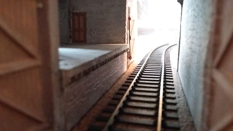

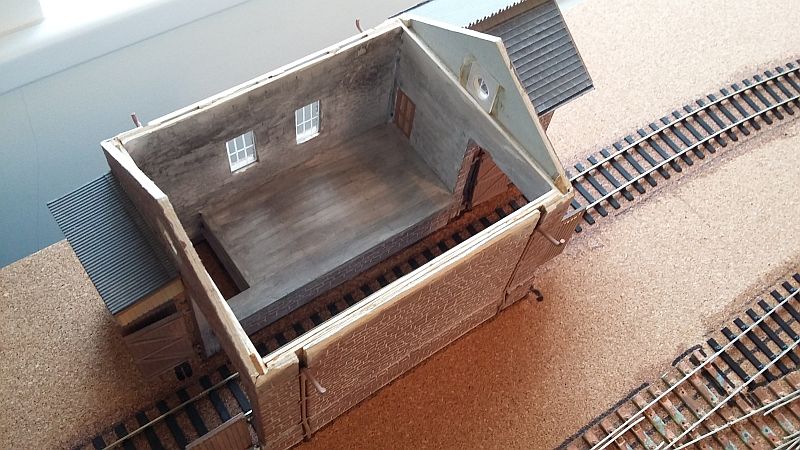

I've now cut the foundations for the goods shed out of the cork underlay. This involved positioning the goods shed (built by Paul Iliff a few years ago) very precisely and testing some locos and rolling stock into the shed itself. Once I was happy with the positioning, I marked all around the base of the walls and cut the cork underlay away:
The goods shed was then test fitted:
