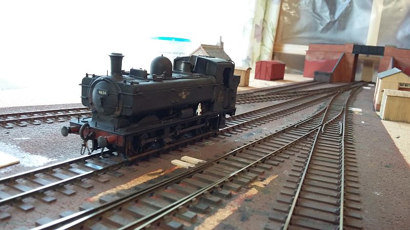

Bit more work done, amongst the incomprehensibly numerous domestic tasks in recent weeks.
Some further test running undertaken this afternoon, during which it became apparent that the LNER had more influence in supplying the light railway with motive power than first thought. Normally it would be very unusual to see two light railway locos in this BR yard.

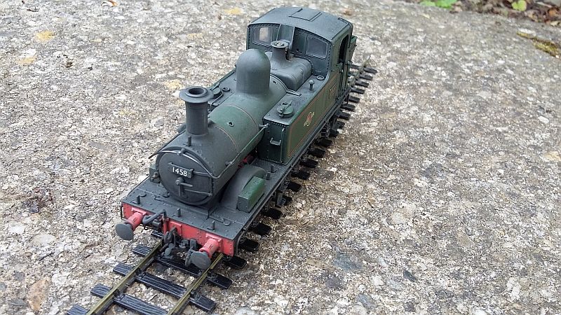

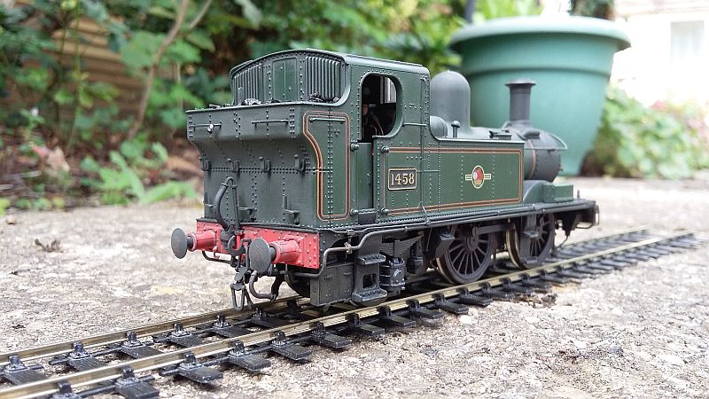

Sadly the GER loco won't actually see any use in the near future, because with back-to-backs of 14.75 mm and the wheel profile that Rapido have used, the loco doesn't like the OO-SF clearances on a couple of the tighter-radius points on the layout. I have the same problem with my second Hattons/DJM 14XX (the one with the original chassis), which has back-to-backs of almost 15mm.
This isn't a problem with Romford/Markits wheels, or indeed those by Alan Gibson. Also, Bachmann and Hornby generally seem OK.
I am going to dry pushing the driving wheels together on the 14XX, otherwise that's going to have a new chassis in due course.
I'm not sure what to do about the GER tram engine, other than dismantle the chassis and look to alter the tread profile slightly and re-set the back-to-backs to 14.5mm.
It's a shame, because the tram engine runs really nicely.

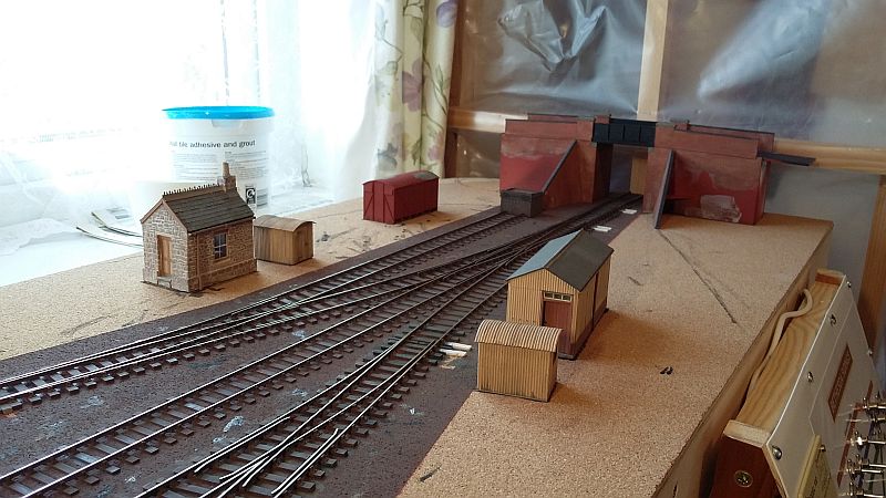

This is the current state of play, not much additional progress really, although cobbling of the goods yard area is well underway and the brickwork on the overbridge has finally been painted and weathered (the girders haven't been weathered yet). The buildings aren't yet permanently attached to the layout, either:

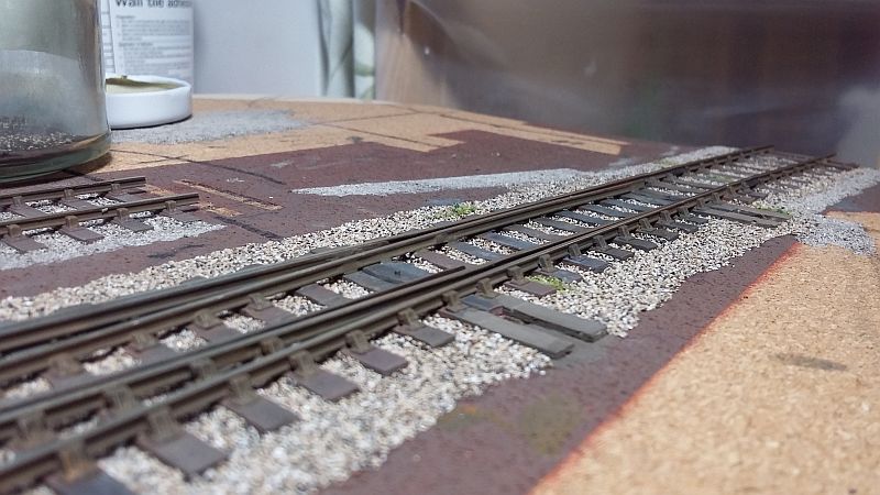

Lovely neat work Tim, ever since I read your account of ballasting the track on 'Engine Wood' I have used your methods. As a matter of interest what ballast are you using there?
Geoff
steve50
Agree with the above, the track and ballasting is stunning!
I'd like to try that method, I'll have to have a look at 'Engine Wood'
