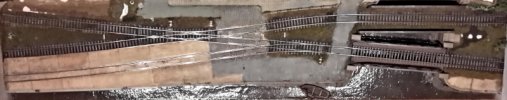

The colour of the water in the basin needs to reflect the colour of the imaginary sky above. Water is by far the more difficult of the two for me, so I really must have a go. Painting the backscene to tone with the water has got to be easier than the other way round.
My experience of modelling water comprises some solvent-encrusted string for an N gauge waterfall (not very convincing) and a modest pond in H0 (better). I have never tackled anything like this basin in my life.
Returning to the waterfront.
On a Dutch HO layout I built many moons ago (since scrapped) I filled (polyfiller) and smoothed the wood of the baseboard - at the same time creating the visible mud at a low/ebbing tide.
This was then painted a brackish/greenish/mud colour as seen in harbours having being churned up by the two tides and vessels. I also attempted to darken the colours towards the centres of the channel, however this is hardly noticable in tidal areas being constantly churned up.
Once dry I painted it with neat PVA and let it set to form a seal then again with annother coat of PVA. While the second coat was drying and became tacky I went over with a largish painbrush in a regular motion and in the same direction to create a ripple effect. The tidal mud was given a coat of satin varnish and the harbour water a coat of gloss varnish. The bridges were installed afterwards.
Here are some pictures to show the effect. Not brilliant by any standards but this was the first time tried to create a tidal scene.
This shows the colour - being at a high angle with no side illumination any rippling cannot be seen
Hi Richard,
On the subject of colour, for the consistency you seek, my first thought would be to use the same colour on the base of any water as that used for the backscene.
I appreciate that you want to have moving wildlife ( which I understand but personally wouldn't want to explore ) so would a smooth perspex/ plastic sheet to which a coat of clear plastic or varnish ( or both ) work.....?
As in, paint the underneath of the clear sheet, which is raised to accommodate any electrickery, then the top of the sheet is pva'd to produce surface texture then top coated with traditional yacht varnish to catch the light......as per mine below.
My only concern would be any gap (s) between the base of any bobbing fowl and the ripples, equivalent to the dreaded gap between a building and the ground.

The basin dominates the diorama but does not need to appear in many photos of stock. I would like to return to it after I have decided whether I should best represent the constantly-rippled appearance at the real location or the much more placid appearance further along the cut. Though Rob's modelling above is very good indeed!
In the meantime I want to explore the photographic possiblities of the diorama, to see how well it can work and what I ought to alter. This is supposed to be a fairly open location, and here are six views of the same wagon in different spots.

I suppose, most real locations have one or two good spots for photos. I want more, so I may end up contriving things. The running-in board might be at the other end of the platform but the layout looks more balanced with it here.

Morning Richard,
Thank you. The water came together very well and there was some relief just how well as being at the front of the layout, there's no hiding !
Looking at your overview image below, I understand your dilemma.
The main consideration is maintaining balance, in that with the tree adding height to the left, you'll need something on the far right, of equal height and stature, but that wasn't your question....
I wonder then , delightful as the green hut is, would something longer but of the same height and extending into the grassy area work better. I'm thinking of a grounded coach body ?
Or......Tree to the right and a similar proportioned tree between the two buildings ?

To be honest, the balancing of the whole scene will improve when the layout has its extension to the right, complete with railway office, and a Lombardy Poplar in place of the Heki(?) model. I'm interested in spots for photos at the moment.
No coach body - too big, too difficult to model, and the wrong image for the railway.
The trees would have been between the railway and the navigation. Some boundary fences at the station will help. I intend to give the platform one oil lamp, this could go to the left of the waiting shelter to help the work of the porter-signalman. If passengers need a second lamp to find the entrance to the station, this can be off-scene.
I rather like being able to lift off the buildings for different photos. I am finding making stock far more rewarding than doing the scenic setting (in 7mm scale), and the trains will be the subjects of the photos I want to take. Sorry if this sounds rather the opposite to so many takes on layout building.

I think that the last image - the one with the running-in board, two figures and waiting room, presents the wagon nicely.
Thanks Graham. Perhaps this is the best photo because it has enough background detail to give context and to allow a pleasant composition.
The exercise has told me, I don't need to remove or move anything I've done so far, and a boundary fence won't detract as long as I make something suitable and do it neatly. Also the water, however I model it, won't spoil photos of stock.
When re-arranging scenic items for photography I usually check the views by placing my mobile phone camera (and other camersa) at 7mm scale eye level which effectively replicates the human scale view. Unless for a specific purpose e.g. overview, during construction; I generally photograph models and scenes on my dioramas from the relevant scale eye level 1:87, 1:48, 1:43.5, etc.
Unless we're standing in an elevated position we would not see the 'helicopter' or 'drone' shots beloved of Railway Modelling magazines.
On another train of thought.... Depending on how exposed your diorama location is and the prevailing winds, wouldn't trees and bushes be leaning slightly leeward as often seen in coastal areas? This would definitely set the scene as exposed and coastal :).
RichardG
I agree. So far, my favourite photos are the ones taken from just slightly higher than eye level, as if the photographer is standing on a crate or perhaps a barge to get a better view.
I will watch out for the vegetation when the time comes. I am putting off the ballast because of indecision on its constitution, but almost anything would be better than nothing at all.
RichardG
A sensible solution to my photos 4 and 5 above is to enjoy this piece of empty space on the layout, and add nothing much more to it.
I am happy with this viewpoint.
If the camera goes higher and I am using a portrait lens (to keep the camera out of the light) I can get a mildly 00 look, something I thought I had banished forever using 7 mm.
So - I have enough space between models to compose quite a few different photos, and the basin gives me vertical space to hold the DSLR. Most of the track looks okay, some needs a bit of cleaning up. I am now rearranging furniture so I can add a fiddle yard, maybe run a train one day :)
