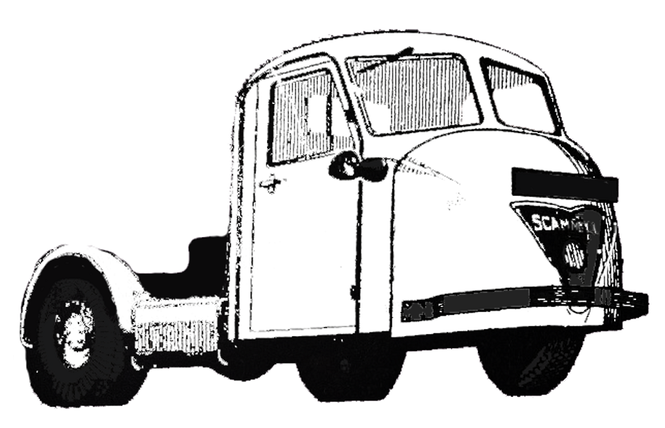

Well, a couple of glitches, but I’m confident that the Mk2 is rather better than the Mk1
I’m astonished how much too tall the first one is. And I checked, it matches the kit.
It would have helped if I had painted the doors, I could have fitted them!
There is a strange kink in the A pillars just below Bert’s hand, on both sides, I shall have to look at the CAD and the printing supports. The roof too has some minor deformations which are due to printing.
Looking at the wheels, the lack of tread (and no deformation at the contact patch) shows, maybe I can do something about that in Mk3.
And thanks to the links provided by @Osgood I discovered that this version of the Mechanical Horse had trailing link forks, rather than the single sided suspension that the Scarab has, so that bit of the model is wrong.
It needs a mirror, starting handle, headlight and number plates, but I’m pleased that it captures the real thing quite nicely.

Very nice Simon. That said, looking - as one does - at images of the real thing in service, I can't help but note the lack of dents in the tin work [coat on, door open...].

Dents would not be easy at the CAD stage, but I imagine the Dremel would oblige…

Brian, when you say “image”, it wouldn’t be a drawing with key dimensions by any chance?
Apropos my comment about the different “gauges”, they’re visible on the Mechanical Horse website, even on the scarab drawings which are certainly later than 1934 - drawing dated ‘57. Curious.

Thanks Giles, that’s kind. I think I’ll fix the errors I know about and leave it till I get to see (and hopefully measure) a real one.
